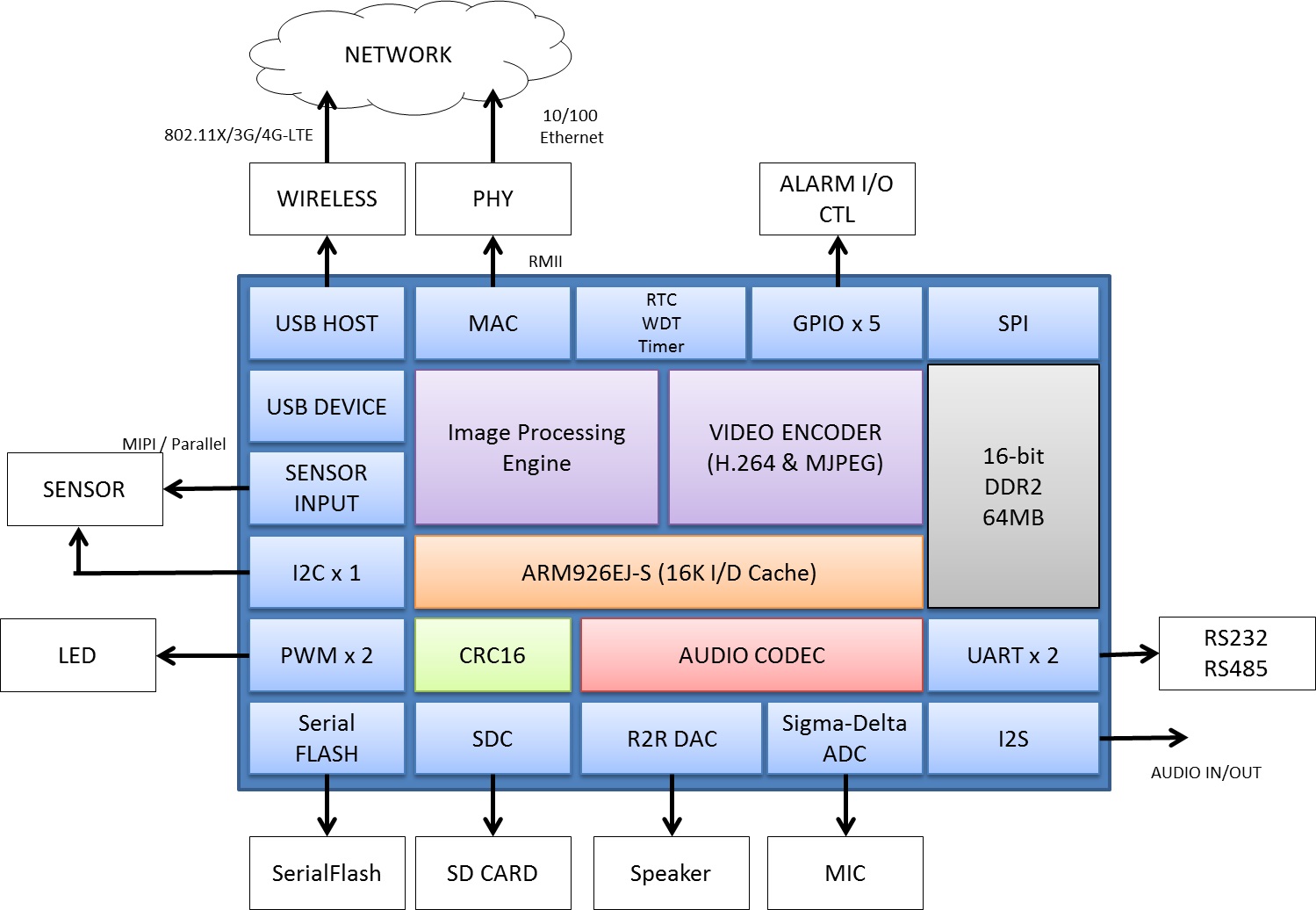

还是后视图,台湾松翰的监控解决方案,官网架构图供参考,
简介:SONiX SN98660 series IP Camera SoC integrates powerful image sensor processing, maximum 1080p30 high-profile H.264 multi-stream encoding, and ARM9 processor with rich peripherals I/O for IP Camera and network video streaming productions. SN98660 series offer excellent video quality and support varied real-time bitstreams, simultaneous multiple streams with different video formats (H.264 and MJPEG), and different resolutions to fit the bandwidth.
SONiX SN9866 series provide fully-featured IP Camera turn-key solution for customers’ development, including network ez-setup, network video stream server for live view, customizable AWB/AE/AF for image quality, video recording, two-way audio with software AEC, motion detection, online update, mobile phone app libraries, SONiX download/ISP tools …etc.
