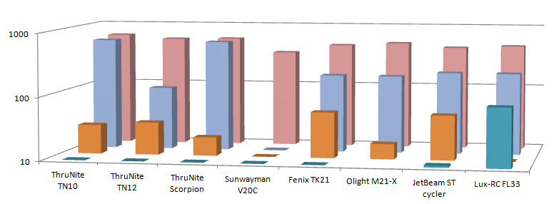

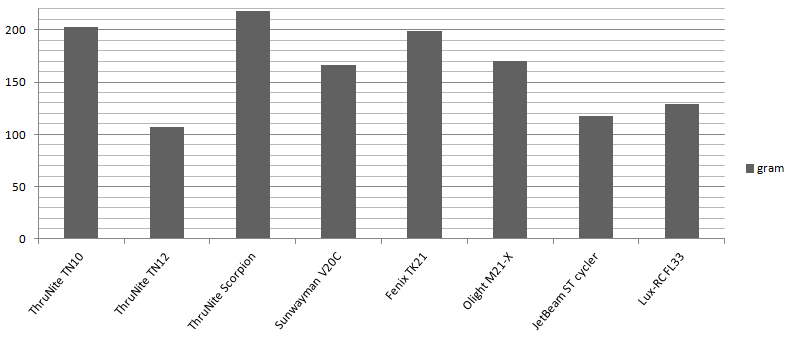

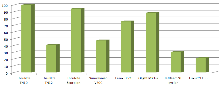

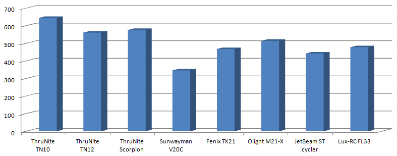

This chart shows the total light output measured with a ceiling bounce.
The TN10, Scorpion, V20C and FL33 all have a fully adjustable range, this gives a high flexibility in brightness. On the V20C this is selected with a ring all the other has a programmable brightness setting.
The TN12 with its small reflector does not have much throw.
The TN12 is a small and light weight light, the other larger lights are much more substantial.

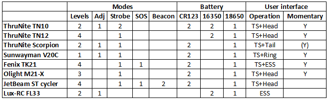

In this table I have summarized the abilities of the lights. For the user interface I use the following abbreviations: TS: Tail switch, ETS: Electronic tail switch, ESS: Electronic side switch, Head: The head is used to select modes, Tail: The tail is used to select modes.

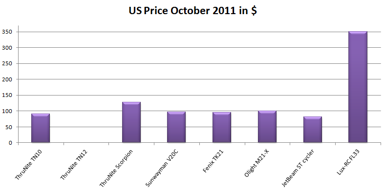

The price for the different lights as found on the internet. The FL33 is a custom light, this makes it considerable more expensive.

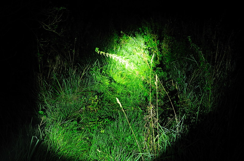

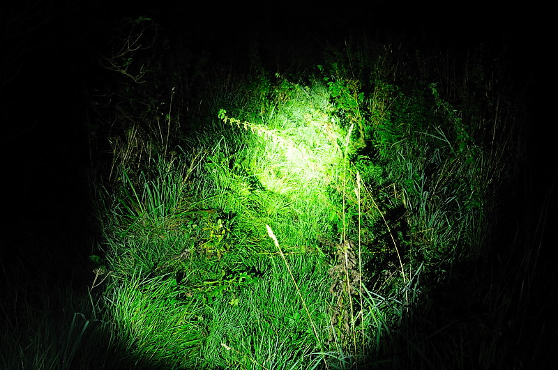

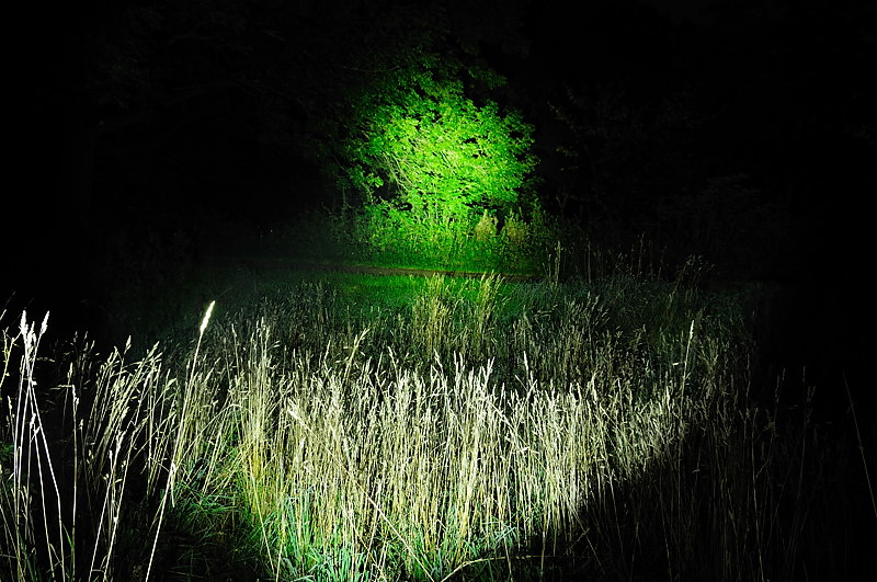

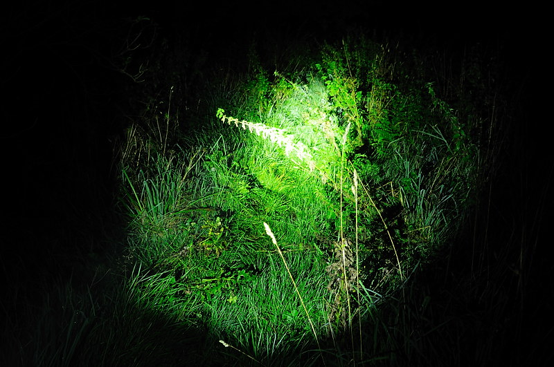

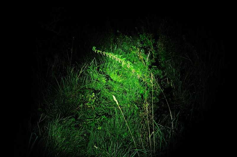

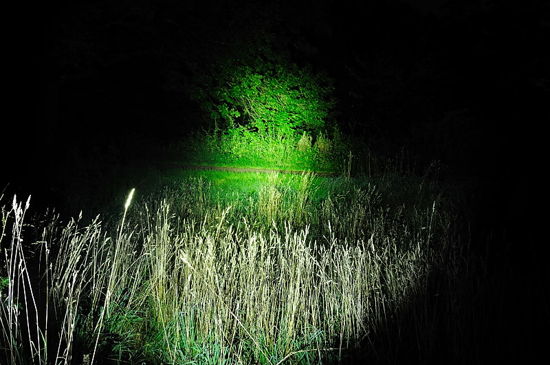

Beam profile, high power
ThruNite TN10, ThruNite TN12, ThruNite Scorpion:
Sunwayman V20C, Fenix TK21 U2, Olight M21-X:
JetBeam ST cycler, Lux-RC FL33:

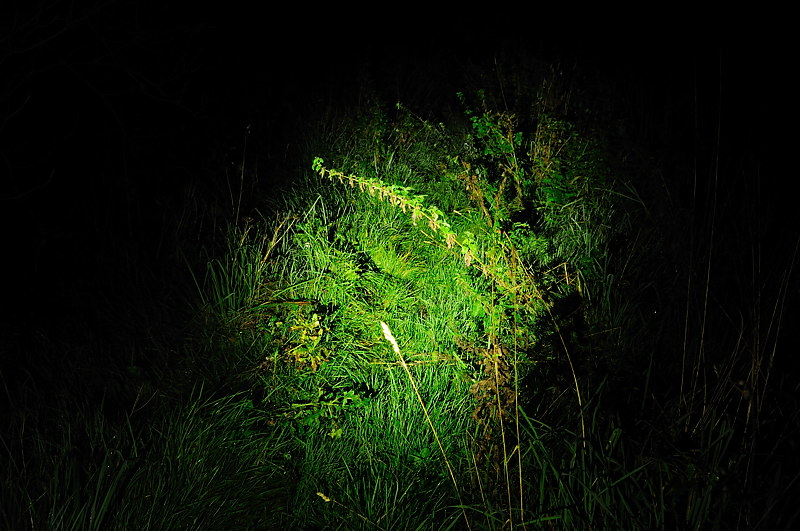

Beam profile, high power, reduced exposure
The reduced exposure makes it easier to compare the hotspot.

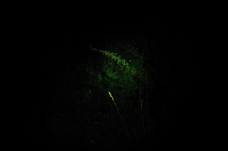

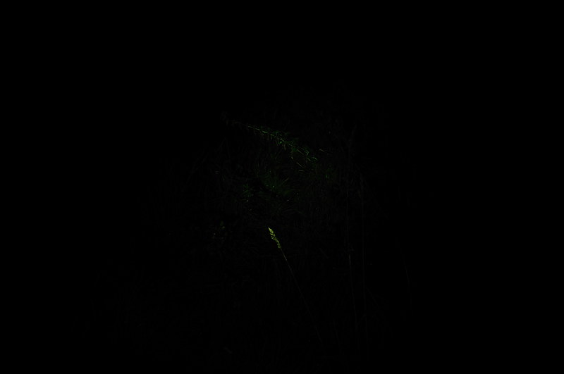

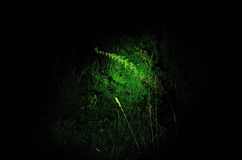

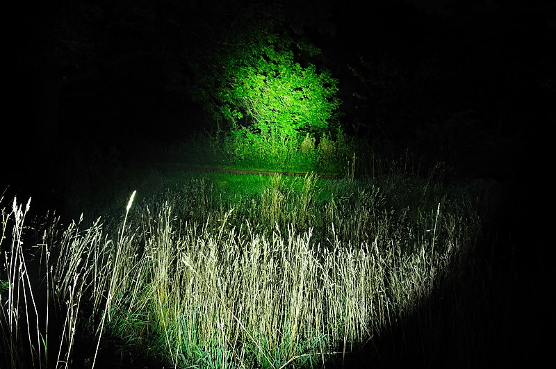

Beam profile, lowest setting
Beam profile, lowest setting, increased exposure
Increasing the exposure makes it easier to compare the low settings. The light with a very low low mode will only show a black picture!

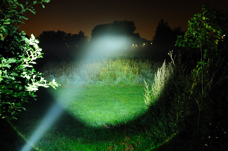

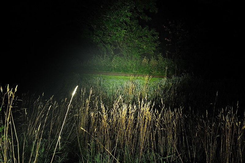

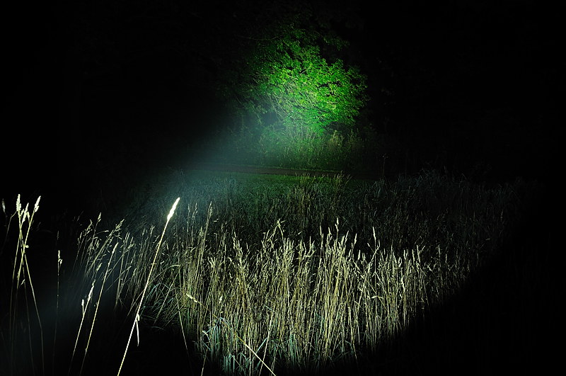

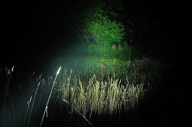

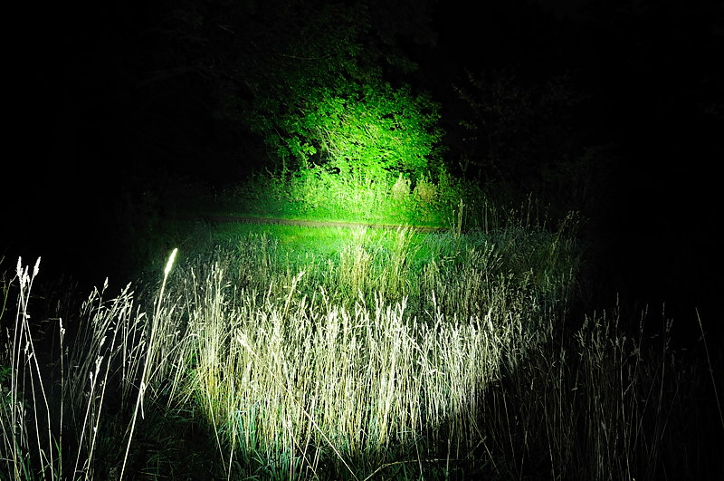

Tree at 15 meters

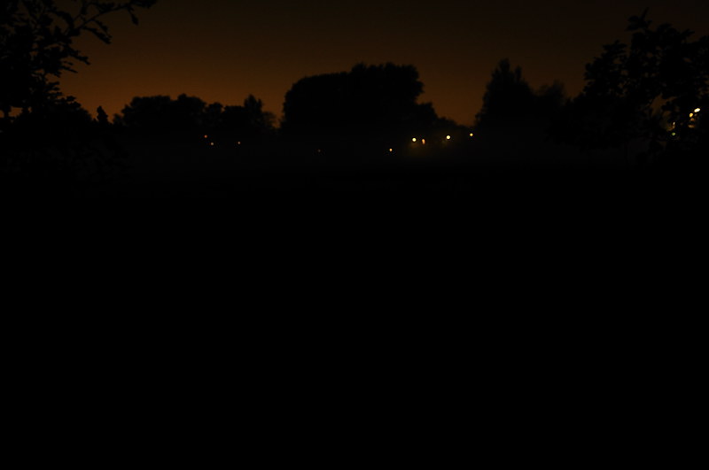

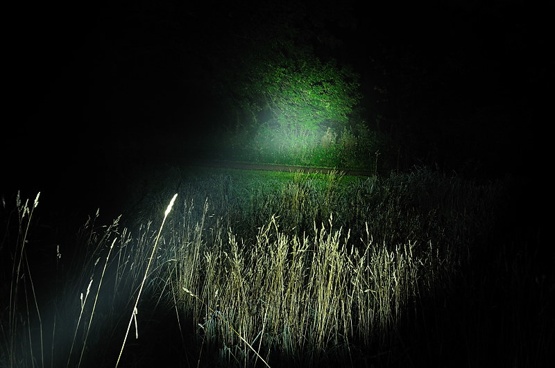

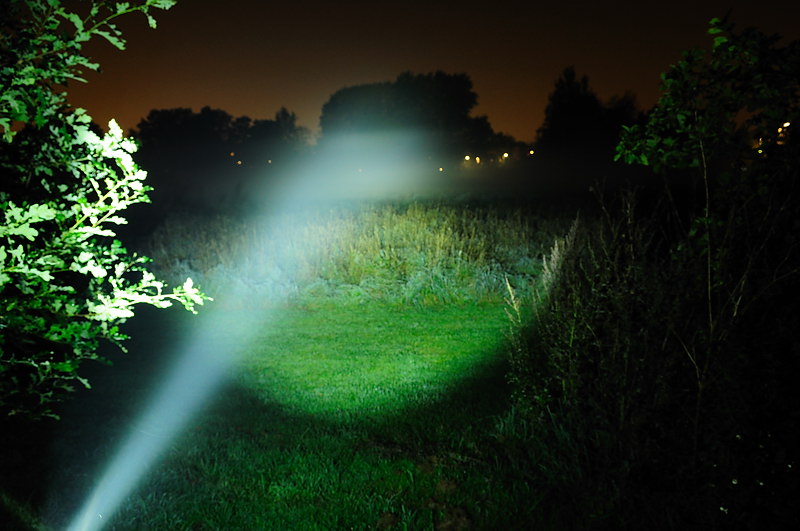

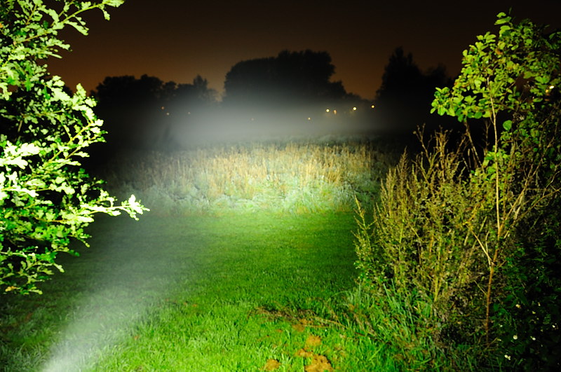

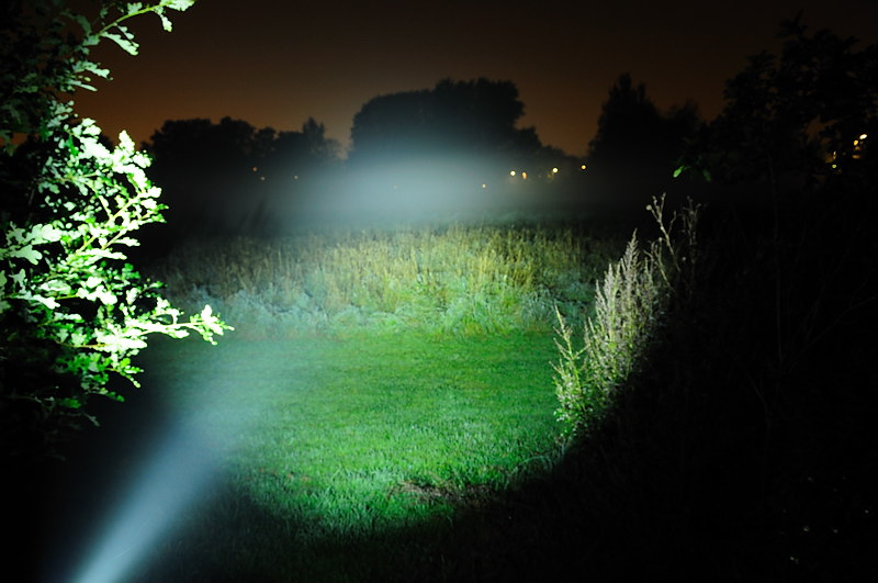

Trees at 150 meters
There was a lot of haze in the air during this beamshot, making it difficult for the lights to reach the trees.
Dark reference

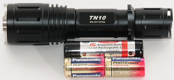

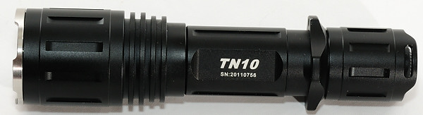

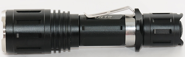

    其中TN10
    ThruNite TN10

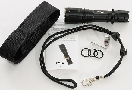

    ThruNite started a few years ago with a small light, then they added a very good thrower (Catapult) and has lately added lots of other lights to their range. The light I am looking at here is a light in 18650 size. The light has 2 settings where one is programmable, to change between them the head must be either tight or loose. On/off is done with a forward tail switch. The light is made of aluminum with hard-anodized (Type 3) finish.
    The light is delivered in a cardboard box with a window and some FL1 specification on the outside
    The box contains the light, 3 extra o-rings, lanyard, split ring, holster, a clips and a instruction sheet.
    The light uses a smooth reflector with a XM-L led in the center. The bezel is in stainless steel.

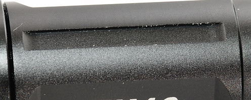

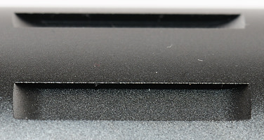

    The head has some groves on it, the edge on the groves is a bit sharp, these does improve the grip. There is also the typical heat sink of high power led lights.
    The backside of the head shows the connection to the battery, this connection is a spring. Around the periphery is a metal ring that is used for mode changes.

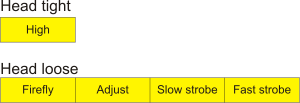

    The user interface has two brightness settings, one fixed with head tight and one programmable with head loose.
    Doing two tight/loose sequences of the head quickly in sequence will activate the programming. The light will repeatedly show the above sequence and a tight/loose sequence will lock the mode/brightness at that point as the programmed setting.
    The battery tube has square cut threads and o-rings to seal the light. The tail thread is anodized, making it possible to lock out the light.
    The body has the same type of groves as the head.

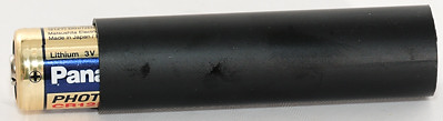

    Inside the battery tube was a extra plastic tube, making it possible to use CR123 batteries with very little rattle.
    The light has a removable tactical ring, this ring can also be used for the lanyard. When removed there is nothing to protect the threads. This ring also works as an anti roll device.
    The body with the clip mounted. There is no lock for the clip, but the tactical ring does help to hold it.
    In the tailcap is a covered spring. The switch is mounted lower than the two ridges, making it possible for the light to tail stand.
    With a split ring mounted in one of the holes, it is possible to use it for the lanyard.

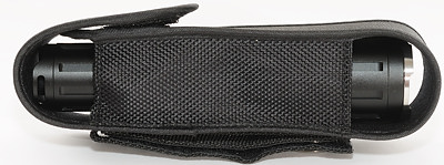

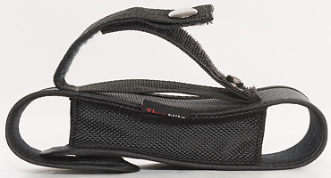

    A holster is supplied with the light.

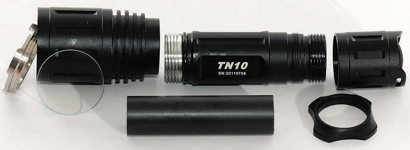

    Here is all the part the light can be disassembled in without tools.
    This light is the usual size for a 18650 light, performance is in the good end both total output and throw. As long as there is only a need for two settings, the user interface is fine and it is easy to reprogram, but reprogramming is a bit slow to use for just changing brightness. For some uses it is very practical that high can always be selected (Just tighten the head).
    I would have preferred that it had full performance in 18650 batteries.
    Technical specification and measurements
    The light is rated for use with 1x18650 or 2xCR123 batteries. The light works fine with all 18650 batteries from 65 to 70 mm long.
    Measured size and weight:
    Length: 145 mm
    Diameter: 24.2 mm to 35.6 mm
    Weight: 188 gram with 2xCR123 and 203 gram with AW18650-26.
    The light uses a Cree XM-L led.

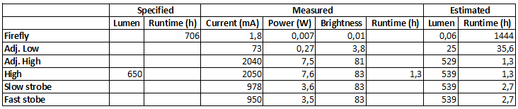

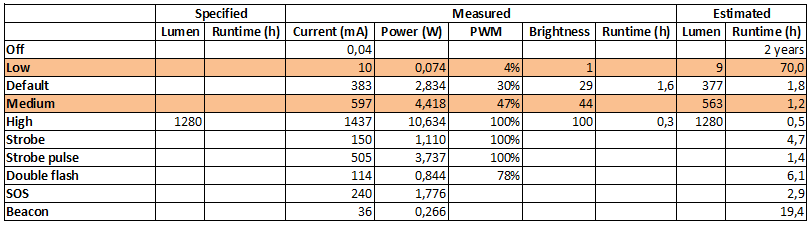

    In the above table I have collected all modes, measured at 3.7 volt (i.e. with one LiIon batteries). All the estimated runtimes are with a 18650 LiIon battery. The estimated lumen is scale from the specified maximum, measured at 7.4 volt.
    Because I have done this table at 3.7 volt, there is no difference between high, adj-high and the high-reduced.

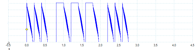

    The first voltage sweep is done in high mode, the light has stabilization down to about 4 volt, this means that it reaches full output with a fresh LiIon battery, but will immediately start to drop in output.
    The reduced brightness is about 80% of max. brightness and can stabilized down to 3.8 volt.
    The adjustment mode has a maximum of about 85% brightness.
    The adjustment mode has a minimum of about 4% brightness.

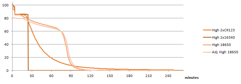

    In the runtime the step down function in high can easily be seen. Neither 18650 or 2xCR123 batteries can maintain a high enough voltage to keep the light in stabilization.
    To see how this light handles the heat, I did a run on my test bench with a temperature sensor on the light. As expected the brightness drops slightly when the led gets hot. The body does get hot and stays hot. There is no step down in brightness (The voltage is to low for this to be visible).
    Note: My test does not simulate actual usage conditions, but are done on a test bench with only the head of the light and no cooling airflow, i.e. the light will get hotter than during normal use.
    With higher voltage the step down is visible after about 3½ minute. This step down does limit the temperature rise.

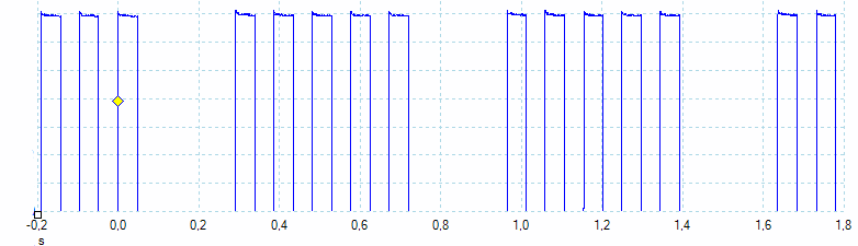

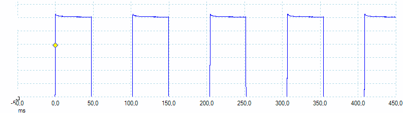

    The slow strobe is 4.9 Hz with 48% duty cycle.
    The fast strobe is 9.8 Hz with 46% duty cycle.
    The light does not use pwm and only has a small amount of high frequency noise in the light.
    Comparison to other Flashlights
    For the full comparison to other lights with graphs and beamshots see here
    Notes
    The light was supplied by ThruNite for review.

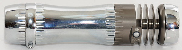

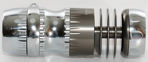

    其中很有特色的Lux-RC FL33也转出来兄弟品鉴一下:
    Lux-RC FL33
    Lux-RC is a Russian company that makes some light products, in this review I look at their newest creation. This creation is a modular build flashlight, i.e. it can be ordered in many different configurations for both led, optics, light engine, battery tube, surface treatment. My copy of the light is with a 11 watt light engine and 3 neutral leds, the body has chrome surface. The light is made of aluminum (6061-T6 alloy).

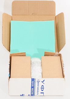

    I got the light in a shipping box, this makes very much sense for this type of custom build light.
    I did not get any extra, except two bodies, but later on the light will include extra o-rings, grease and lanyard. It will also be possible to buy clips, larger bodies and some mounts.

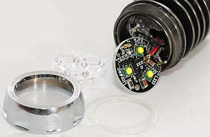

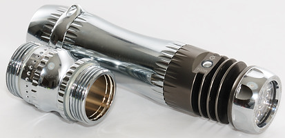

    There are 3 main leds in the head they do not use a reflector, instead they have TIR optics. It is possible to order different leds (cool, neutral, warm) and different optics. Besides the main leds there is also a small red light that flashes about every 5 seconds for 0.012 second. This makes it easy to locate the light in the dark and does not use much power.
    It is possible to open the head on this light, where the light engine is placed. This engine can be replaced with new versions, i.e. when a new better light engine is release it is possible to buy this as an upgrade to the light. It is not required to do any soldering to replace the light engine.
    As usual on high power lights it has some cooling fins, but here they are larger than usual and an important part of the design.
    The switch is placed on the head, just behind the heat sink. It is an electronic push button. Around the button is the battery indicator, when the switch is activated the ring will illuminate in a color for some time, the color depends on battery level. If the switch is activated just before the battery is empty, the indicator will flash for 15 minutes.
    This indicator works both for one and two LiIon cell.

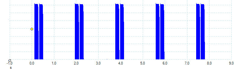

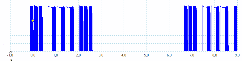

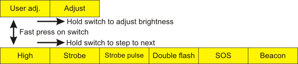

    A fast press on the switch will turn the light on in the user adjustable mode, another press will change to high output. A longer press will turn the light off and a even longer press will change mode. The switch is a bit hard to press, i.e. a soft finger cannot activate it, a nail must be used.
    It is a bit difficult to get out of the flashing modes again, it is necessary to either loosen the battery tube or step through all modes.
    Note: This user interface is part of the L333 light engine and will be changed in the future.

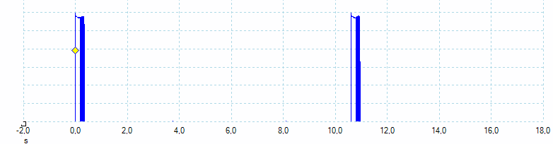

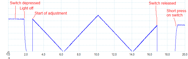

    This curve shows what happens when the switch is held down in adjustable mode, first the light turns off. If the switch is held down for some more time it comes on again and starts ramping up and down. Release the switch somewhere in the ramp and the brightness is remembered as the new setting.
    The head also has some markings with the serial number, battery voltage, etc.. The warning about "Hot surface" is very real on this light, when running on full power it can get very hot (See my temperature curve). The serial number can be checked online to get the exact specifications for the light: Specifications for review copy.
    The battery connection in the head is a spring with a gold plated covering.

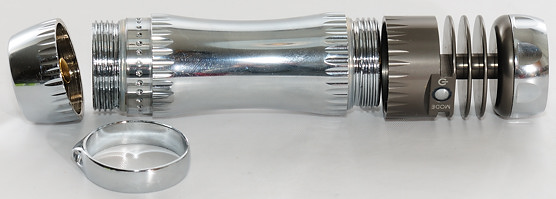

    The battery tube has square cut threads and the two ends are interchangeable.
    A lanyard holder can be mounted on the body.
    The tailcap is concave and the light can easily tail stand. The tailcap has a covered spring for the battery connection.

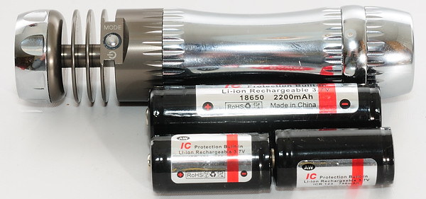

    I like the idea of a user customable light and I also like the special design of this light. I got the light with neutral leds and combined with the high output this is a really nice flood light. As can be seen in this review there are a few detail that could be better and many of them are going to be fixed in the next generation of light engine (Called L334).
    This light is to expensive if you want "just a flashlight", but if you like the design and want something more special, I believe this light is going to be a good candidate.
    The light can use one or two LiIon batteries, in the short configuration this is one 18350 or 16350 battery, preferable IMR. In the long configuration it is 2x16350, 2x18350 or 1x18650, again IMR is preferred for the short cells. Because my light used a light engine without any battery protection I had to use protected 16340 when using two batteries.
    This light does not have any problem with long, short or fat batteries. Both flat top or button top can also be used. The price for this flexibility is that the battery is a bit loose in the tube and can rattle.
    Next generation of light engine will include battery protection, i.e. it will be possible to use two 18350 LiIon in the light.

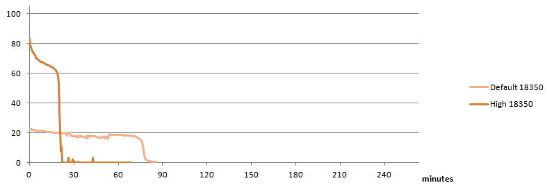

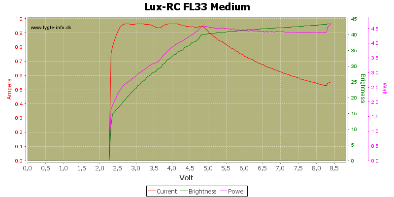

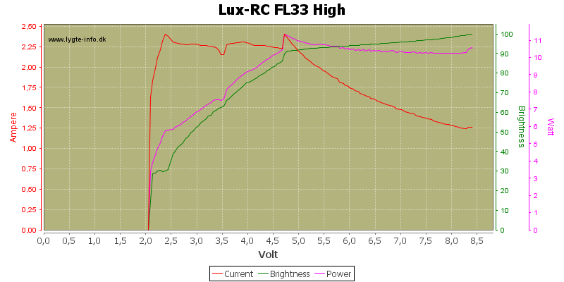

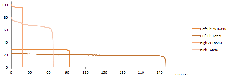

    The first voltage sweep is done in high mode, the light has stabilization down to about 4.6 volt, i.e. it is not stabilization with a single LiIon battery. The dip at 3.6 volt is probably a battery low warning.
    Medium does work exactly the same way, except it draw less current. When not running in high the pwm is audible.
    The above curve shows runtime in the long configuration. As the voltage sweeps shows a single LiIon cell is not stabilized. The runtime with 2x16350 is also very short.
    The 7 watt engine is stabilized with a single LiIon cell according to Lux-RC.
    Using the short configuration, only a single LiIon cell can be used, here I am using a IMR 18350 cell. This gives a very short runtime, it would probably be wise to select a light engine with less power for this configuration (This is decided by the user when ordering the light).

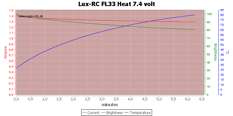

    I did a temperature test to see how well the light handles the heat from the led. When power is turned on the temperature rises fast, without any automatic reduction in brightness.

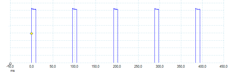

    Same test, but with the voltage from a single LiIon. The temperature does not rise as fast, but it still rises fast.
    This light must not be run without cooling on high!

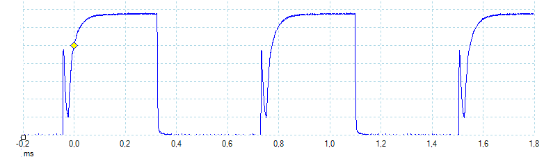

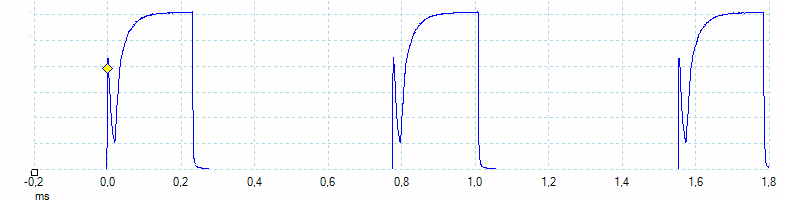

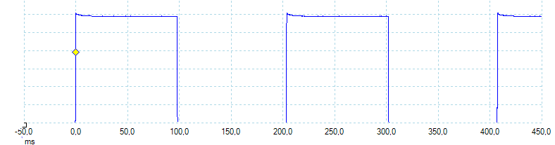

    The light uses pwm at about 1.3 kHz, this pwm in the user adjustable setting, but not in high.
    PWM at the default and the low setting.
    The strobe is at 10.4 hz with a 10% duty cycle. This gives a long runtime in strobe mode.
    5 pulses and a short pause.
    Two flashes each other second.
    Sos, with a total time of less than 3 second to transmit, it is a very fast sos.
    The sos has one problem, in the above curve I have filtered the pwm and as can be seen the sos fades, instead of turning off, this makes it more difficult to read it.
    The beacon is one flash each 10 seconds.
    Lux-RC FL33, Olight M21-X, Fenix Tk21 U2:
    ThruNite Scorpion, ZebraLight SC600, Klarus XT10:
